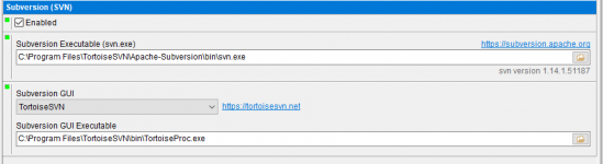

I just got a new Windows laptop and after I imported my PSD Config settings, I was surprised that the Version Control configuration settings weren't set up for TortoiseSVN, as I've used since PSD added native Version Control support.
I looked through the Config.ini that I'd created from my old laptop and was surprised to not find a [Version Control] section or any reference to TortoiseSVN.
Marco, where are the Version Control settings saved so we can restore them?
Can someone tell me how to configure the Version Control settings for TortoiseSVN?
Specifically, I don't know what to enter for svn.exe prompt value on the Subversion window. (see attached screenshot)https://www.screencast.com/t/euBiz4W1pc
Thanks in Advance,
Stew
Thanks very much for the tip.
I didn't get an email notification from the forum, so I just stumbled upon it now.
For those of you who might wonder what to do with the Zip file, as I did, I created a subdirectory under the \TortoiseSVN, then copied all the files there.
Then in PSD Config, I referred to the svn.exe in the new directory. Once I closed and re-opened one of my versioned files, worked like a charm.
