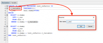

Hello:
I have the following problem when using variables indicating the procedure / function name. First of all the Highlight variables doesn't work. And "Refactoring -> Rename item" it doesn't work either.
Best Regards,
