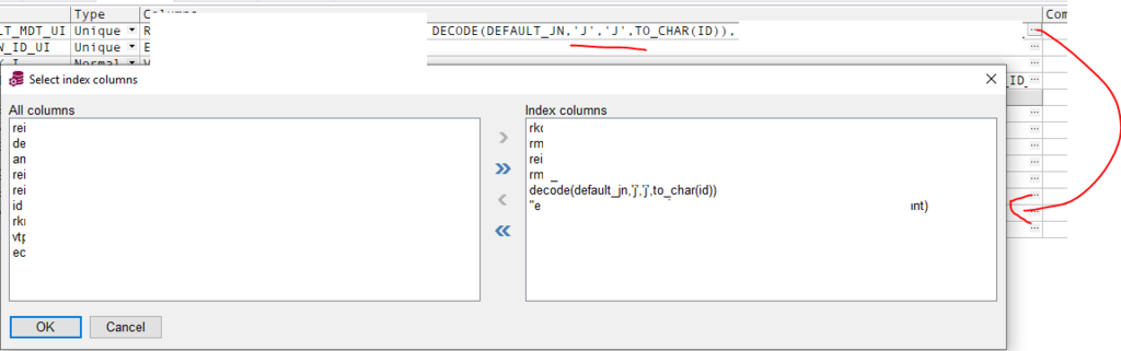

We found unwonted Edits on Indexes.
1. open a Table to edit Table
2. Klick on definded Index on the tree point button
3. the edit dialog is opend and display as one line now lower
4. do Nothing and close with OK!
in the background still waitung a ddl with the lower Values
Problem: if a made additional real changes and press apply and do not take a look in the real DDL - my function based index ist wrong - in my case it was a unique index that goes wrong

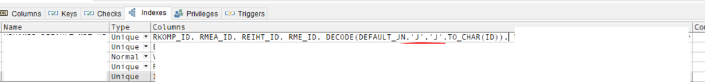

	.. RKOMP_ID, RMEA_ID, REIHT_ID, RME_ID, DECODE(DEFAULT_JN,'J','J',TO_CHAR(ID)) ..2. Klick on definded Index on the tree point button
	DECODE(DEFAULT_JN,'j','j',TO_CHAR(ID))4. do Nothing and close with OK!

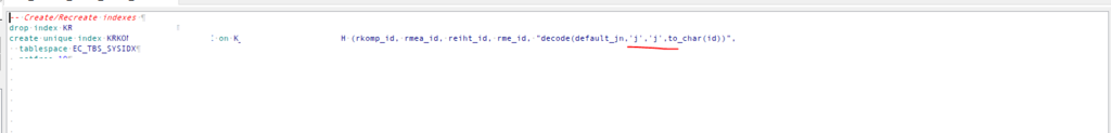

	drop index..
create index .. RKOMP_ID, RMEA_ID, REIHT_ID, RME_ID, DECODE(DEFAULT_JN,'j','j',TO_CHAR(ID)) ..
