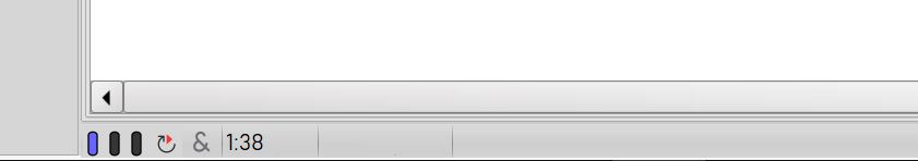

Here are 2 pictures for illustration
...after a select has been executed.
1.
The status line does not show any information about the duration and number of lines in the result set

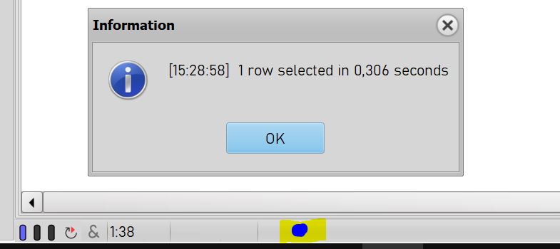

2.
But after double-clicking in the specified area, the information is shown in a dialog.
I tried it again with the setting: Light, Light style . And now I can see the missing information. So it really seems to have something to do with the chosen theme.
Thanks for the information. It turned out that the message panel is not visible if you have not enabled the "Allow multiple connections" preference. We can now reproduce this, so we will fix it for the next beta.
