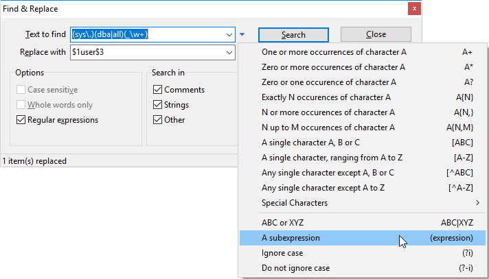

Marco,
Since you mentioned this new V13 feature, I decided to try it out for the first time. I think I found a minor bug in the Special Characters menu? The option "Tab character" is listed twice in a row.
I'm hoping you can see this in the attached screen shot.
I'm running V13.0.0.1883
