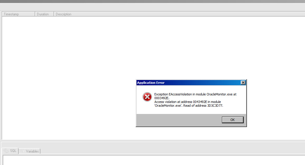

At times it will just crash with a random error message like this one

Hello thanks for the reply, I just tried running it as admin. It neglected to show many of the queries and then had an access violation error crash again. These are the versions I'm using for all of the software:

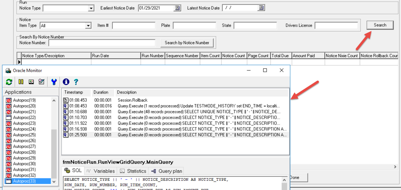

When it's functioning it shows queries when pressing this search button:

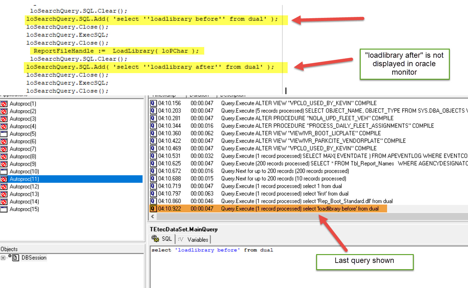

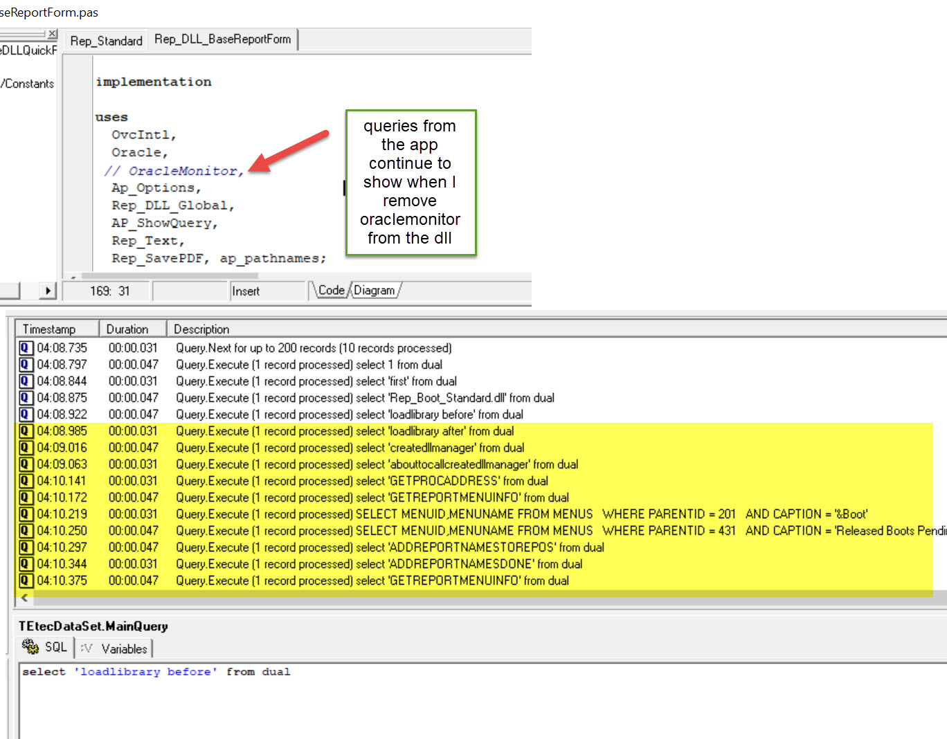

The issue occurs when the LoadLibrary command is called on a DLL that also has OracleMonitor as a unit. If I remove OracleMonitor from the DLL project then oracle monitor continues to report correctly. But that solution would not work because the DLL loads reports and without OracleMonitor included in the DLL project then oracle monitor does not show queries when the reports are being run.
This shows the log queries added and the 2nd query not displaying
Then the queries do display when I take oraclemonitor out of the DLL
So LoadLibrary messes things up when the library being loaded has oraclemonitor in it also. I already tried using SafeLoadLibrary, it made no difference. I thought maybe there is a line of code I could add somewhere that would kick it into working again or a code change I could add to oracle monitor to fix this maybe?
