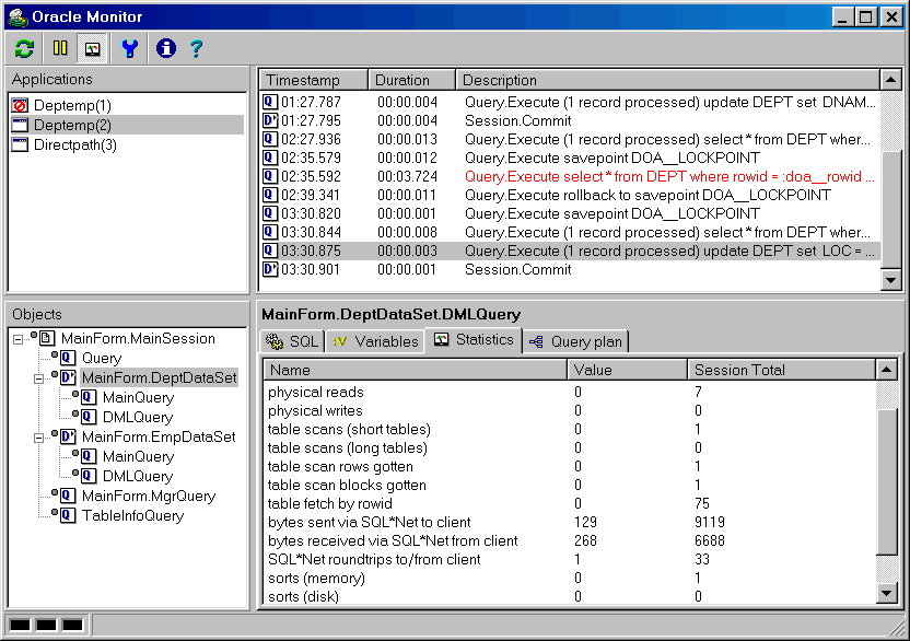

If there are no locks, I cannot imagine what the problem might be. Can you use the OracleMonitor to verify that it is indeed a SQL statement that is hanging?
Download it from our web site, "use" the OracleMonitor unit in your project, run the Monitor (the Monitor item from the Oracle menu in the Delphi/C++Builder IDE), run your application, and watch what happens.
