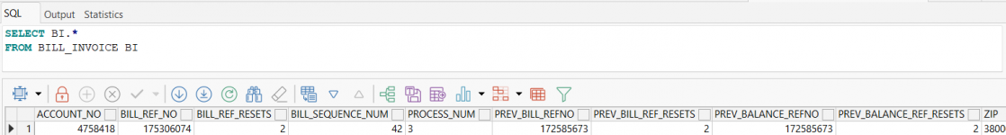

When performing a select bi. from bill_invoice , the screen that displays field names displays the field names in alphabetical order, and this occurs for some tables. In version 15 there is this problem. The correct way is to display the field names according to the table structure.
Note: This occurs for tables with a large number of fields

At the bottom-left you can press on the sort button to switch between alphabetical and physical order. This option is persistent, so you only need to press the button once to change it to your preferred setting.
