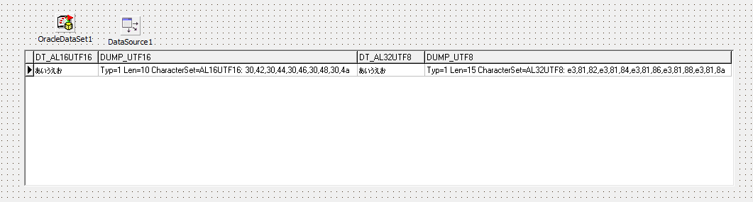

Hello
The indication of some Japanese letters stored away by VERCHAR2 is not right.
I link the picture of the test result.
Item name NAME_NVERCHAR2 and NAME_VERCHAR2 are the same Japanese UNICODE data.
Why will indication be different?
Will any setting be necessary for TOracleSession?

Hi, Marco.
Thank you for coping with my problem.
I Set TOracleSession.BytesPerCharacter to bcAutoDetect.
and I use TWideStringFields.
Will not unicode support DBGrid of delphi2009?
I think that TOracleSession may fail in conversion to UTF16 from UTF8.
I want you to test the next SQL in delphi2009.
If conversion succeeds, should see the same Japanese data...

Will not there be the method to display Japanese of VERCHAR2 normally?
Hi, Marco.
Thank you for testing it.
Your result is right.
It is the result that I want.
but, I cannot get it by my setting.
Why will be it...?
Will you teach your setting in detail?

Hi, Marco.
Thank you.
I think. Is this a problem of the VISTA OS?
I tested it.
VISTA for English ver --> No problem (result same as you)
VISTA for Japanese ver --> Japanese Mojibake (result same as my)
VISTA for Japanese ver, I cannot use DOA now.
But this problem occurs only in TOracleDataSet.
TOracleQuery is No problem.
ShowMessage(OracleQuery.Field(2)); --> not Mojibake
ShowMessage(OracleDataSet.Fields[2].AsVariant);--> Mojibake
ShowMessage(OracleDataSet.Fields[2].AsString);--> Mojibake
ShowMessage(OracleDataSet.Fields[2].AsWideString);--> Mojibake
What will you do?
