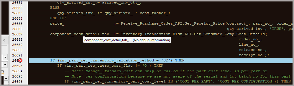

In a nutshell: even when compiling packages with debug info. I notice that, when I step into the code for SOME packages (not all of them) the variables show "(No debug information)"

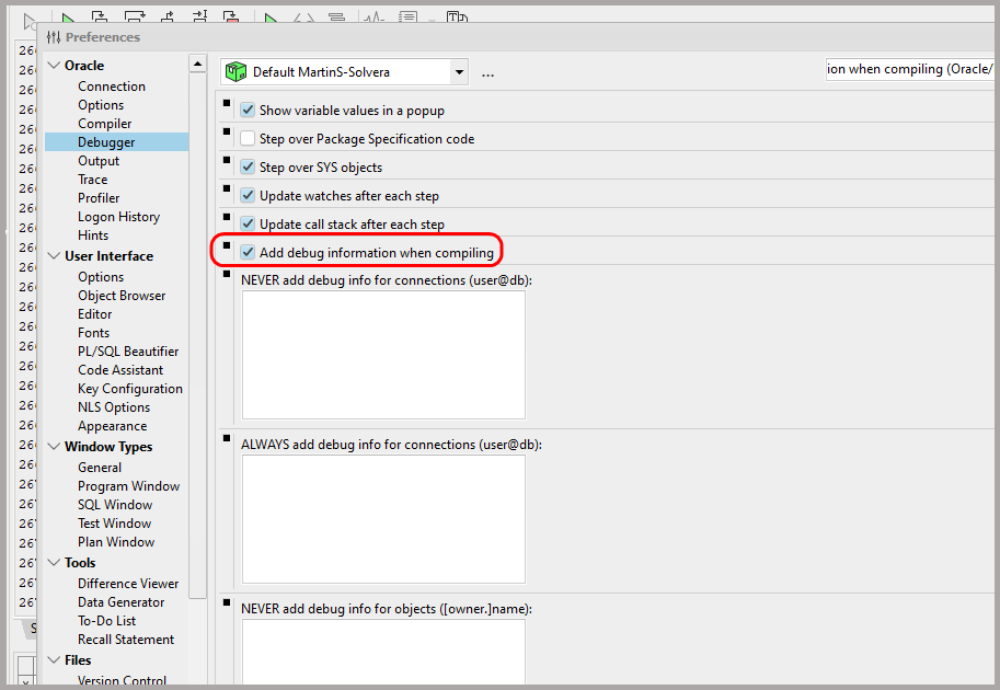

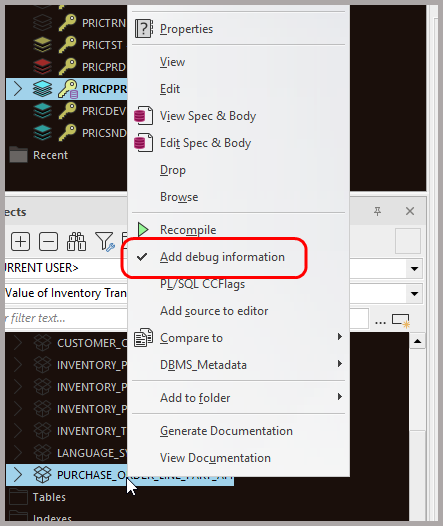

Like I said, I can debug the offending package and even see the checkmark beside “Add debug information‿.
I even have checked the “Add debug information when compiling‿ (another reason to believe that this is not causing this problem).
